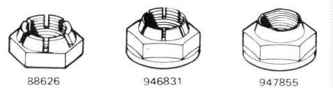

Op de volvo bertone site het volgende gevonden ;
Aanhaalmomenten
Nm
(kgm)
Flens, moer 88626 (3 /4" UNF)...................................................
240-300
(24-30)
moer 946831 (3 /4" UNF).................................................
200-250
(20-25)
moer 947855 (M 20x1,5)..................................................
200-250
(20-25)
![[Afbeelding: grp46-02.jpg]](http://www.volvobertone.com/images/grp46-02.jpg)
Deksel..........................................................................................
50-70 Nm
(5-7)Kgm
Kroonwiel, bout zonder flens.........................................................
70-80
(7-8)
met flens...............................................................
90-110
(9-11)
Wielmoeren...................................................................................
100-130
(10-13)
http://www.volvobertone.com/grp4262n.html#46
